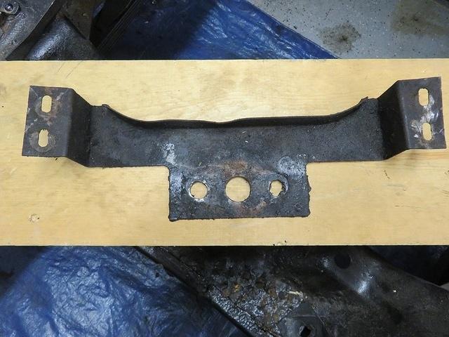

« Reply #6 on: December 05, 2017, 10:04:31 PM »
Kim & Tom,
Since my motor is out I snapped a picture of the front support for the side gravel guards.  If you guys need.., once I get the piece cleaned up I could trace it so that you could make one on a sheet metal break.
It bolts under the front engine mount.

« Reply #7 on: December 05, 2017, 11:05:27 PM »
That would be great .  Bend paper to piece ,  trace on  and send me a copy . Gladly reimburse  you .

« Reply #8 on: December 06, 2017, 02:55:36 AM »
Yes, that would be great!  Flat pattern is fine (folded for mailing), maybe dotted lines to indicate location of bends.  Thanks a lot, Chet.  Kim Mc

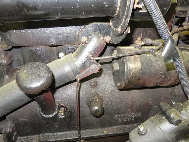

« Reply #12 on: December 07, 2017, 02:55:24 AM »
Yeah . no problem here either . Make sure your rebuilder puts the longer head stud in right spot , for horn mounting .
Tom, My horn mounts to the water intake casting on the side of the block not the head bolts.

« Reply #13 on: December 07, 2017, 08:08:42 PM »
My horn mounts the same...took me forever to find that horn bracket!

« Reply #14 on: December 08, 2017, 03:36:18 AM »
I see . Mine being later engine and horn  is off second stud from back on top .
