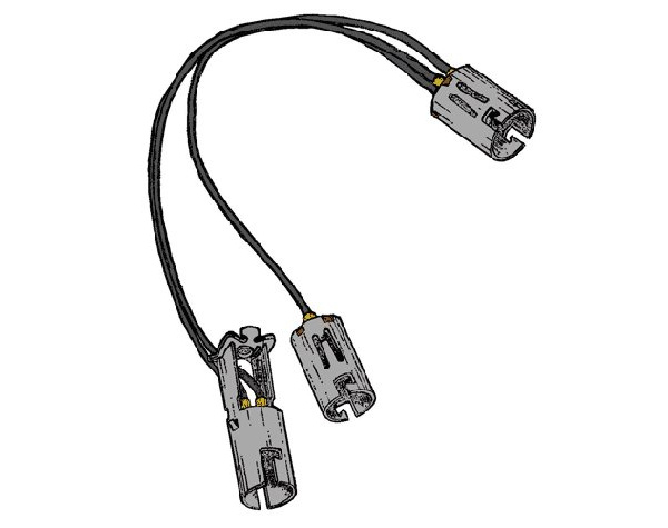

can someone supply a photo or the harness connector that plugs the harness into the bucket on Depress Beam system? I have the three wire plug on the end of the harness (see photo below) but need two of the connectors to orient the three wires into the bucket. I don't know what they look like. Tried to find a supplier to purchase them with no luck. The connector coming out of the bucket is made to receive two pins like a lightbulb. http://www.1948plymouth.info/28Q29U/index.php?action=dlattach;topic=959.0;attach=3576;image for any help Rich

Is this what you are looking for:
See attached PDF
These are Model A Ford parts.
The Filling station offers these parts for Chevy twilight depress headlight same as Dodge / Mopar .
29plycoop
#3
Thanks for the reply. I did see that these were available. The connectors I am looking for are the ones that plug into the connector you show that comes down out of the headlight bucket. The one in your photo in the upper right corner. I was hoping for a photo of the connection of the harness into the headlight bucket. Not sure what that connection looks like unplugged.  Thanks Rich

29plycoop
  Russ T Fender !! That is the connector view that I needed. The black three wire plug is orianted into the metal sleeve that is in your photo by the narrow slot down the outside of it. The metal sleeve connector with the the black three wire plug inserted pushes into the Depress Beam bucket and twist locks in place with the two pins on the outside diameter. Thank you for the photo. Now it all comes together.
