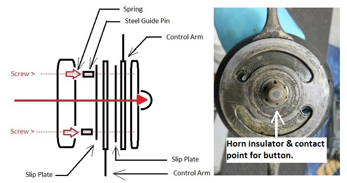

Reassembly - CLUM Switch/Horn Button  :)
Long write up.
I'm glad this is finished without any damage to these very rare parts.  There is a lot of info already on this site which helped make this a little easier.
Due to the length of this task and the number of pictures, I posted a link to the blow by blow description below:
http://www.1948plymouth.info/1929/Work_files/2019/11242019.htm
Great explanation and pics Chet!  As you know, I did this last year and it is fairly easy if you take your time with it and follow the process as you laid out.

Good job Ted, My main concern was dropping one of the control tubes and busting off one of the arms.  So far so good.  :)

I am right at the point of doing what you just did and can't tell you how great it is to have your pictures and narrative available as a reference.  Doing this stuff blind is scary when you realize that replacement parts don't exist if you screw something up.  What a great resource!

Russ, That's why I encourage everyone to share there repair experiences.
BTW... If the horn wire doesn't come out easily you might have to pry the insulator up.  Make sure you get under the insulator's bottom metal ring.  Pry between the adjustment slide and the metal ring.  In my case I had to pry on both sides at the same time before it came free.
