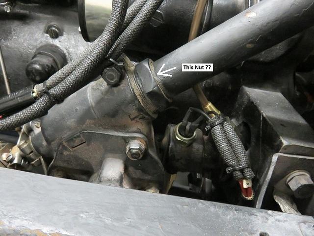

Chet, I am not talking about the steering worm adjusting screw and lock nut.  I am referring to the large nut on the column itself that screws into the steering gear housing.  I believe it is referred to as the steering gear worm adjusting nut and is right above the steering gear housing clamp bolt which locks the housing on to the steering column.
Are you talking about this Nut below:
Or are you talking about the Nut on the back side., opposite the Pitman Arm.  I believe the front side (Pitman Arm) might be a reverse thread. ??  I don't remember.
If the threads are visible you can run a thin wire or nail to see which way the threads turn.  Just a suggestion.
That is the one.  I was able to remove the steering gear housing by unscrewing it counter clockwise as opposed to using the nut that you show.  I assume the normal procedure would have been to use the nut but it won't budge.  I was going to apply some heat but do not want to damage anything.   That nut appears to be used to move the worm gear up and down on the steering shaft so I assume it must turn although I guess it's possible the nut is just there to hold the column while you screw the housing on.

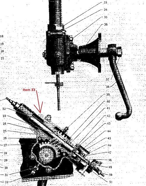

That may not be a nut but part of the screw assembly #33 see below.
That nut is listed as thrust adjusting nut . You must first loosen dash bracket and bottom clamp . So that says to me it is fixed to tube . The nut / tube is then snugged down and backed off 1/4 turn . This is done with front end off ground .
Thanks that is just the information I was looking for. That's why I was asking the question.  I assumed the nut had to move on the column but in fact the nut turns the column.
