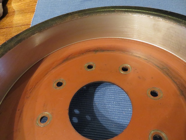

I took the car out for a test drive and same problem.
I took my spare front wheel drum to my local NAPA machine shop and they cleaned the drum with a minimum cut.
Picture below.
Spent the rest of the afternoon removing the existing drum.  Had to heat it to persuade it to slip off the wheel hub.  Needless to say this is my worst wheel so the hub also came right out.  Not good since it should be press fitted to the wood spokes.  That's another decision for another day.
Anyway after much inspection of the old drum I found that it wasn't out of round but worn in the center and high on the inner and outer edges.  What was happening was my new perfectly square shoes were only touching on the inner and outer edges with one inner high spot ?  I am going to see if it can be cut square.  It might be to far gone.  We will see.

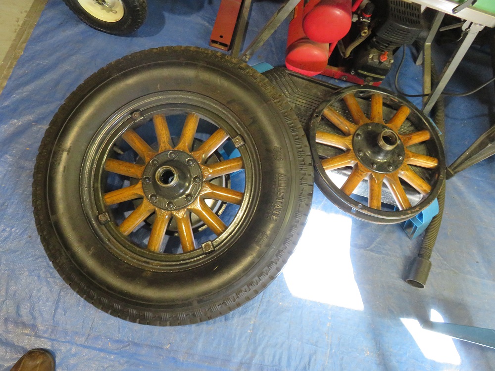

Now you are giving me reason to do some repairs.  The good news is with all the rain here the hub tightened up and hard to move.  Maybe we might try the raw linseed oil and see how much it tightens up. I don't want to wait a year.
I have this recently respoked set of Plymouth 19" wheels (2 Front / 2 Rear ).  Excellent condition. I will however have to buy tires.
The good thing is that tire selection for the 19" wheels is a lot better than that of the 20" type.
The tires that are currently on these wheels are ( 6.00-19 6 Ply ) and look larger than my 20" wheels which are ( 4.75/5.00 4 Ply )
They look like truck tires.
Before I but tires/tubes etc does anyone know of any technical issue with swapping these wheels.  Once this is done If I ever wanted to have the originals redone the work time wouldn't effect moving the car around.  Also the wife likes the wood look better than the painted wheels.
