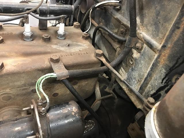

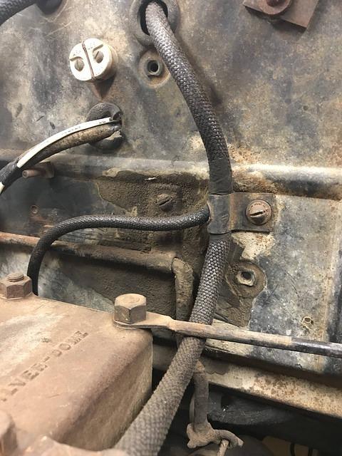

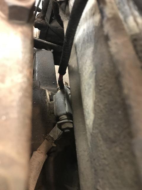

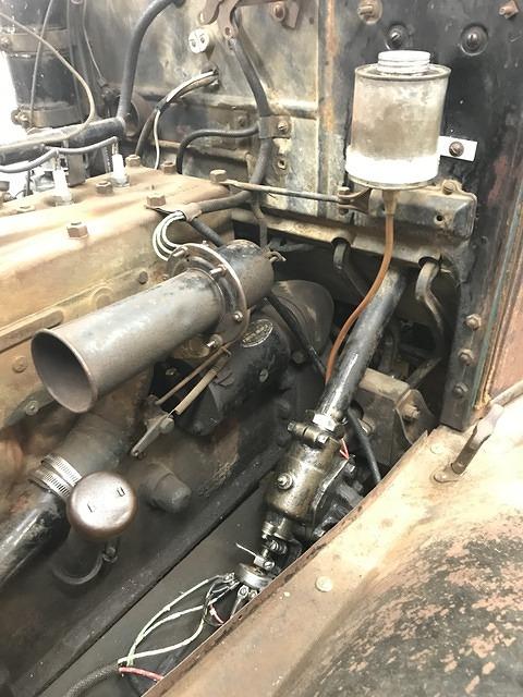

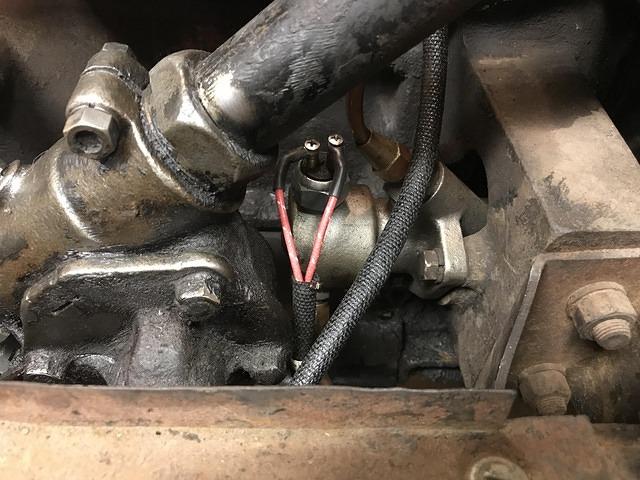

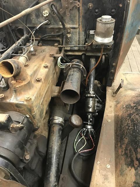

I'll snap a few, just did this last July.
Have been short on time this week, if you need any details let me know. The white wire with the speedo cable was (is) my temporary fuel pump power. Ignore. Followed YNZ's setup for the most part. They have power for the clum fed from the horn, that is why there are 2 green wires. (I know its the wrong horn) If anyone has an extra right one they want to part with let me know.
Horn looks like a correct Klaxon 12C to me.

That one is an 8C, buy off of some random guy at a tractor show. It serves the purpose for now...
Basically Who else has this bracket ?

My '29 Ply coupe has this flat wire strain relief from out from the head. FYI

That is the way the original harness was run, I believe this bracket is original and correct for your car and mine.  I just don't happen to have this bracket or if I do, I don't remember removing it.  Possible, maybe having a senior moment.  In my case I am not sure how I will handle this since I am dealing with 5 additional wires for signal flashers.   At this time using this bracket doesn't seem practical for me.  The new harness would be better positioned down the firewall in the direction of the steering column.  Here it would tie into the front light harness and the rear light harness.  Wire connections would be hidden by the frame.  There is always some minor trade off for safety additions.  Not there yet, the engine is still in the shop so its another thing to ponder.
