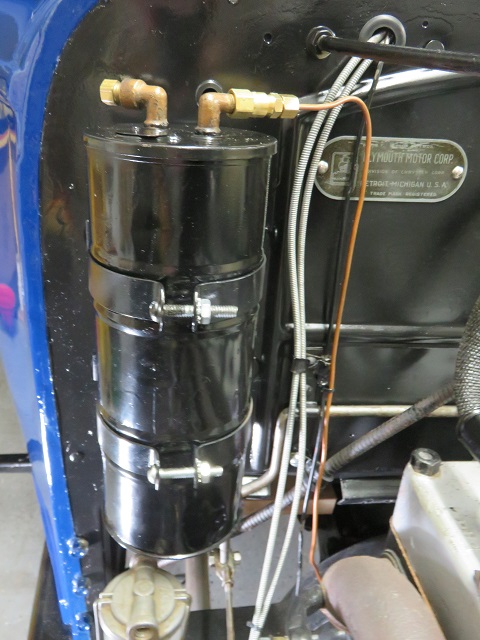

This is how mine was.., I can swear that it is original.., I have only owned the car since 2004  But it seems correct ?
Both cables are attached to the top screw of the gas peddle linkage hinge bracket along with the oil gauge line.  Cables to left and the oil line to the right.  My oil line is the small black line in the picture.  The bright coper line is vacuum going to the oil pump
Thanks Chet.  That is interesting.  My oil line is on the other side of the engine right under the starter and on my car the line from the intake manifold to the windshield wiper is where your oil line is.  I see how the cables get held together on the firewall but where does the timing cable get attached after that point?  One thing I can see is that  the 30-U carburetor linkage is different than '29.  Mine comes off the back of the bell housing and is not attached to the firewall.  The mounting screw on the firewall is still there so I guess it is still used for the cables.  Do you have any idea what the opening right behind the vacuum tank is used for?

Quote from: Russ T. Fender on May 17, 2021, 08:05:13 PMDo you have any idea what the opening right behind the vacuum tank is used for?
Manifold vacuum line for wiper motor.  Runs down and along side the vacuum tank.

Thanks again, I think I have the firewall routing down now!
