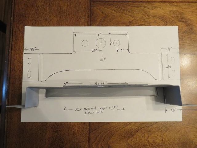

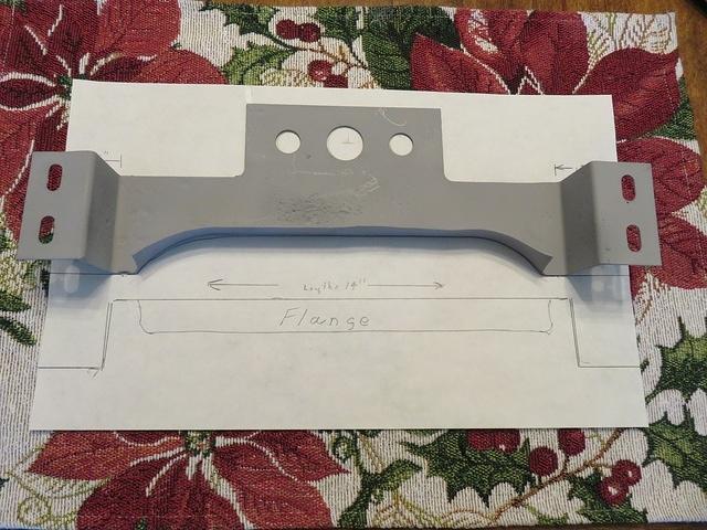

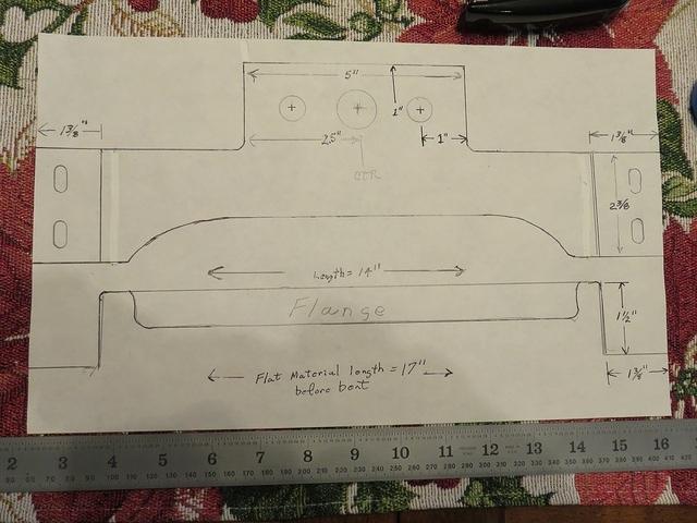

Kim & Tom,
I traced the front pan support.  The pictures below illustrate how I traced it.  The flat length of the material would be 17" long 16 gauge steel by 4.5"wide (actual measured 4 7/16" wide)
If you want I can make copies of the 8.5 x 14 document and send it to you.  Just email me your address.
If you can print an 8.5 X 14" document download the attached pdf file
kimmc
Hey Chet.  Thanks for taking the time to do this.  I think I can manage the fabrication from your very complete drawing.  Best, Kim Mc
