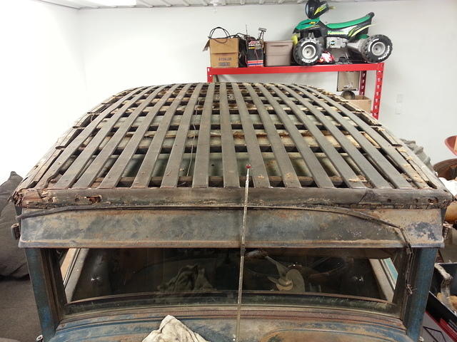

If the 29U 2 door Sedan is anything like the 29U 4 door Sedan the roof is not plywood.  There is a slight arc left to right and front to back.  I don't think you can accomplish this with just plywood?
Below is a picture of crazzydave's original roof.  You can browse his pictures in the "Off Site - Photo Gallery"
jjohn
The car has a plywood in the roof maybe change some time?
Most original cars I have seen are bows and slats.  If the plywood will work and is easier to do, go for it, once covered nobody knows.
