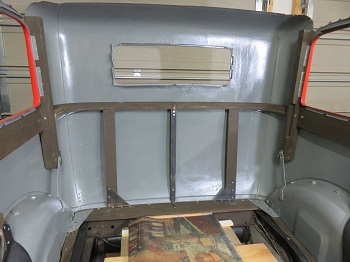

With the complicated work of creating the left & right side sill plates and also the rear cross sill behind me.  I completed the construction of the passenger side hinge pillar.  Basically I reversed everything I did to the driver's side and applied it to the passenger side.
Once all the wood was positioned properly I squared off the rear body assembly.  Using dimensions I calculated and verified with actual measurements from forum member <29UJohn> who also has a 1929 Plymouth 4 door sedan.  I bolted everything down.
The strength of this rear section is now comparable to a newly constructed car.   I will move on to new work like  rebuilding the rear seat frame assembly and rear window frame which will add even more strength to the rear section of my old car.
