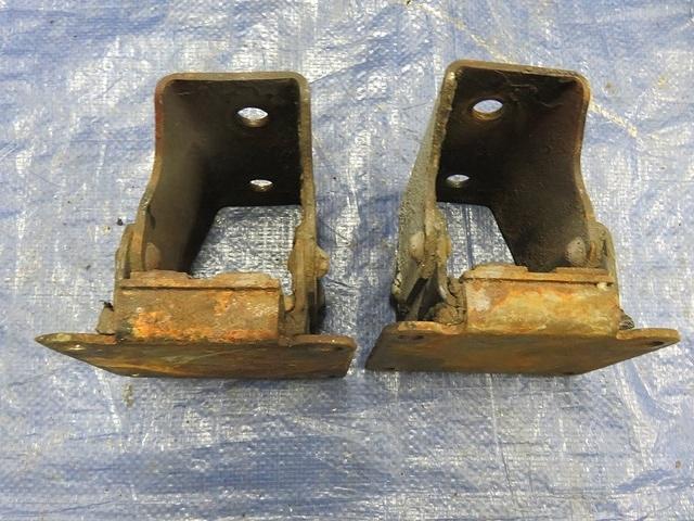

Anyone have these rear mounts re-vulcanized.  If so how did they come out ?

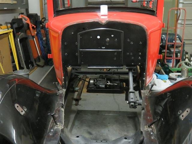

While the motor and other items are out for repair I cleaned up the front section of the frame.  The electrical harness arrived rather quickly so I also stripped the firewall and prepped it for paint.  Once these final areas are cleaned and painted I can install the wiring harness and get the car ready for the rebuilt engine.  Fingers crossed.
I removed the rear motor mounts.  These items have been in the car since it was manufactured.  The rubber was as hard as a rock.  I will send these out to have new rubber volcanized onto the existing mounts.  I painted the inner sections of the front frames.  This was the only portion of the frame that I hadn't gotten to.   I cleaned and painted the outer sections when I did the front suspension work.
Getting the firewall ready for paint basically took two days.  Stripping all the brackets and misc. items allow me to be able to strip the old paint off.  It's much easier to do if you don't have to negotiate around objects.  So it took two days to prepare the surface to spray 60 seconds of primer twice.  I was able to bring the garage air temperature up to 63 degrees with 36% humidity.  Not bad considering it was in the high forties outside.
The space heater in front of the firewall is just to keep the temperature near the firewall at 70-75 degrees.   Primer dries quickly so I will let it dry for a couple of hours.
Saturday the outdoor temperature might possibly go into the low 60's.  If it doesn't rain I'll paint the finish coat.

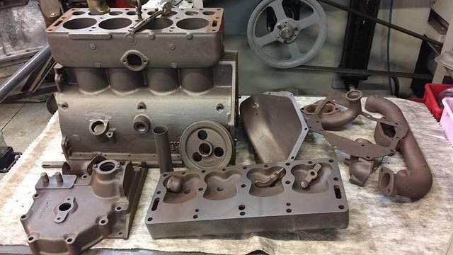

29U Engine Refurbishment Update:
All engine parts have been cleaned and crack checked.  NO Cracks in either Head or Block.!!!
Link to all engine progress pictures at J&M Machine.
https://www.facebook.com/pg/J-and-M-Machine-Co-Inc-270076059772640/photos/?tab=album&album_id=1467684380011796

Now that's pretty.  How much of the babbitt will be used again?
  • POC MEMBER
  • Senior Forum Member
  • Posts: 1482
    • View Profile
    • My Space on the Web
Re: 29 Build Thread - Part 2
« Reply #28 on: January 11, 2018, 02:54:02 AM »
In talking to John the builder.., he said everything new.  I know for sure they will redo all the babbitts (Their specialty).  New rings & pistons.  I will ask him for all the old parts since he said the pistons were the original correct size.  I didn't plan on any performance touch ups. Stock.

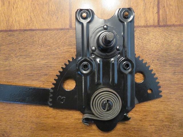

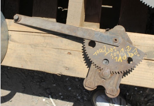

I founded this window regulator on eBay.  It was frozen and not functional.  I was able to clean it up in my ultrasonic cleaner.  The ultrasound did a great job freeing up the mechanism.  The paint will preserve it for another 100 years.   BTW my driver's side door regulator's teeth were gone.  This one was a welcome surprise.
Part after cleaning, lube, and paint.
