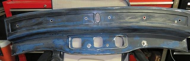

Below is a picture of my dash from a work effort I haven't posted yet.  In sanding and working on the dash I believe the Blue that is coming up is the same blue overspray I found on the remains of some original wood pieces.  Can I definitively say that someone else didn't paint this car Blue before it was repainted Red, maybe or maybe it is the original color.  Who can really say.  Below the blue was a very stubborn, porous & gummy black.  This is the same I found on the firewall.  Primer or topcoat ?
I think as time goes on being 100% correct is impossible but getting 85% right might be attainable.  The main and most important thing is to be 120% happy with what you have.  I will have to read over the POC judging guide. The jury is still out but if I am not convinced I will comply to general agreement unless something other than that makes me happy.
:), Chet...
Chet,
As you reiterate, who knows for sure, and they made running changes during assembly.  I have Depressed Beam headlamps; roadster has Two-Lite.  Does this mean along the way both the Two-Lite were replaced on the sedan?  Could be, but they looked pretty neglected when I got it.  Oh well, another deduction, if having it judged.
I met Joe at a summer meet in Grand Rapids, MN.  I'm glad to hear he's still around and, I hope, in good health.  He was very cordial and laid-back and gave me a few suggestions on what was right and needed correcting without being heavy handed. Please say hello for me, although he may not remember me.  With his car and Dave's as examples, you can't help but be correct.  In my old age I have shaded from strictly 100% original, e.g. upholstery.  The blue is as close as I could find to the original and the headliner is a complementary shade of blue.  I've seen the "original" light taupe headliner and didn't care for the way it looked, so...
