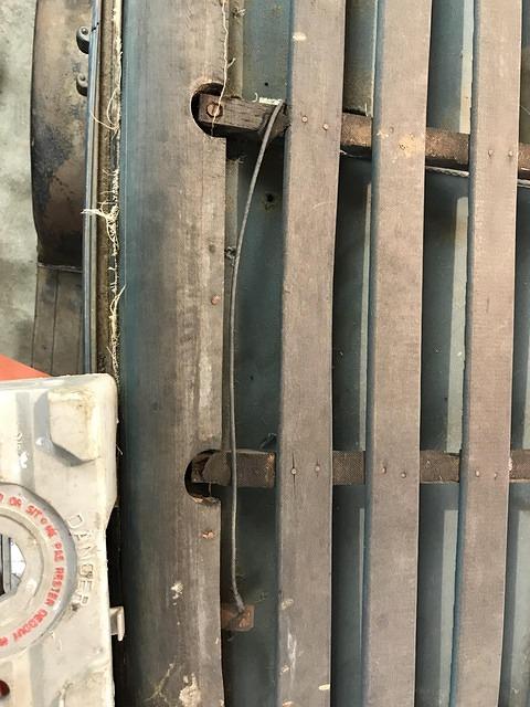

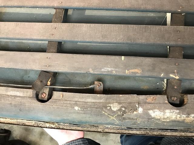

This afternoon while laying out the roof bows I realized that a bracket that is attached to the top of the center door post has nothing to attach to.  I originally thought that this attached to a cross bow but neither Dave's pictures or another picture I have show a cross bow in this area?
The question is where does it attach to or is it something that was added to support the roof that a previous owner installed ??  Any comments.  See pictures below:
The Top Center Door Pillar.

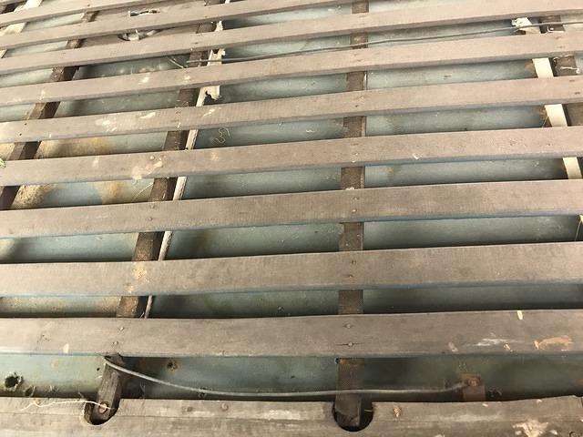

A picture of another 29 Sedan.  No cross bow in the area of the center door post ??
This is not Dave's car but the bows alien with the measurements Dave sent me.

Chet,
If memory serves, on the passenger side this hole bolted the ground wire from the dome lamp.  The wire routed through holes in my bows.  Does Dave's pictures show this?  I would guess there is no right/left for that long piece of iron.
frank
Franks a winner!
Only purpose is to ground (positive) the light, but a picture is worth a thousands words they say. So I took some.
Memory come through again, amazing.

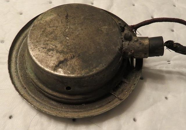

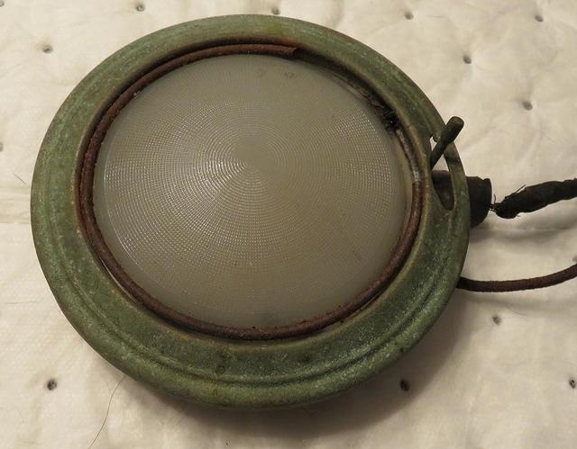

Chet,  do you have a dome light and the mounting board?  I may have some pieces.    frank
You guys are Good !!!
This is the dome light that came with my car.  Hopefully it is correct for the 29U
It's been sitting in an old tool box since I got the car.  Yes there is a metal tab on each door column but the one on the passenger door is broken.  I guess I will bend them back into the up direction.  I thought they were for a cross member.
Very Cool...
A little polish and your good, Chet - looks like the one in my car.

Here is part of the wood mount for the dome light.  You get the idea Chet, mounts between bows.
