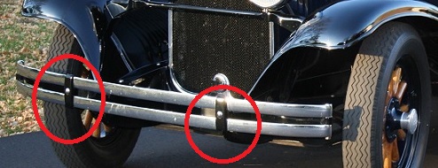

We are talking about the item circled in the picture below:

Tail lamp = "bucket" + "door,"  bracket is black, as you say.
Now for the 29 bumper, I left out the word "plate" that you so kindly circled in red.  I did the rear in black also.  These pieces are supposed to have a shiny metal rectangular "cap" over them.  When you see Joe H's car, note how these look.  He told me what belonged there and had them made for his car.  My plate has a slightly raised portion where this thin, rectangular piece fits.

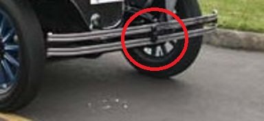

My understanding for the 28 bumper is the same as yours. Here's a 28 left rear for your collection.
Wow, the support assembly is painted black.  I spent a lot of money having them plated.  Oh well...
They were plated already so I just assumed that they should be plated.  Knowledge is sad a day late and a dollar over spent.
Mine are painted black, rear and front.  frank
Mine are black as well.  Everything else with the bumpers is chrome on mine.
kimmc
Those parts on my car were once black as were the "retainer plates" on the front of the upper and lower chrome bars that hold those two bars in place.  Except for the chrome bars, I plan to have all of these parts powder coated black.  Has anyone else done this?

Well, I called the plater to ask if he got to this job yet.., he told me he was just about to call me that the parts were done.
So I probably spent more that 2K to chrome parts that were suppose to be painted black.  :(   I have had this car for almost 12 years and I didn't notice that this was not the case since the parts on my car were chrome when I bought it.   It look nice so I never suspected anything different.
Ted when I looked at your car I never made the connection.
The next guy that does this car 50 years from now can paint these parts.  Very Frustrated !!
I had my bumper supports powder coated gloss black at the same time I had my wheel rims done.
