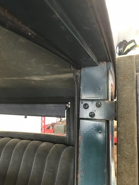

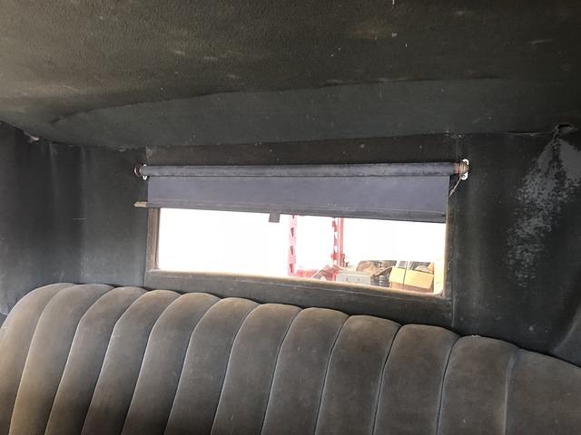

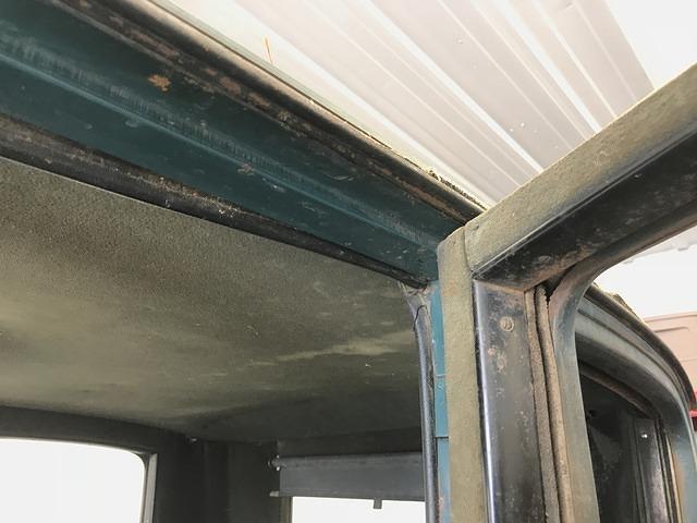

Hi Chet.  I have some pictures attached of my '29 coupe that may help you.  One picture shows the P-side door frame with windlass-type seal along the inside edge of the door opening.  This picture also shows the 4-piece garnish molding around the rear window.  Also note above the upper left corner of the rear window (L in picture) one of the two hangers for the roll-down type rear window shade.  I do not remember that there was any weatherstrip anywhere in the door jambs or door frame but I could be wrong about that.  The pictures don't show any evidence that a rubber seal was ever there however.  If I find a picture that clearly shows the hinge post and open door, I will send it along.  Kim

Based on his, I did the windlace in a flat black vinyl.  Kim's picture shows the vertical and horizontal across the top of the door interior.

I'll try and get a few pictures up for you tonight. My rear window has upholstered trim around the frame in the inside.

so that rear window blind is original? wow, mine has that, assumed someone added it!

Is the rear window moldings fabric covered wood or metal.  It looks like wood to me.
Guessing wood by the way the tacks/nails are holding on the material. But not 100% sure with out peeling it apart.
