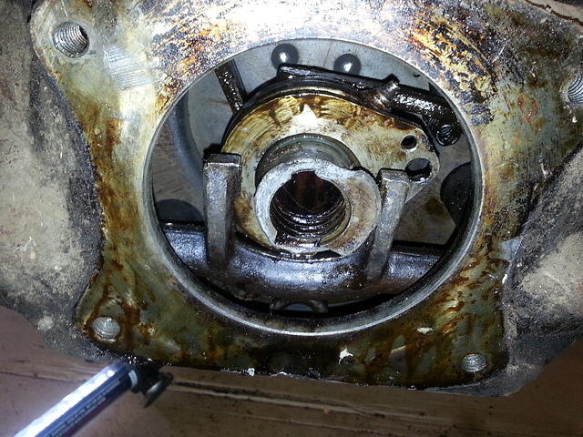

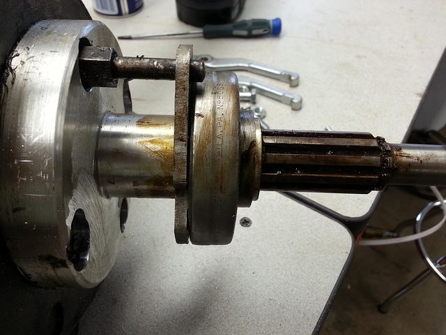

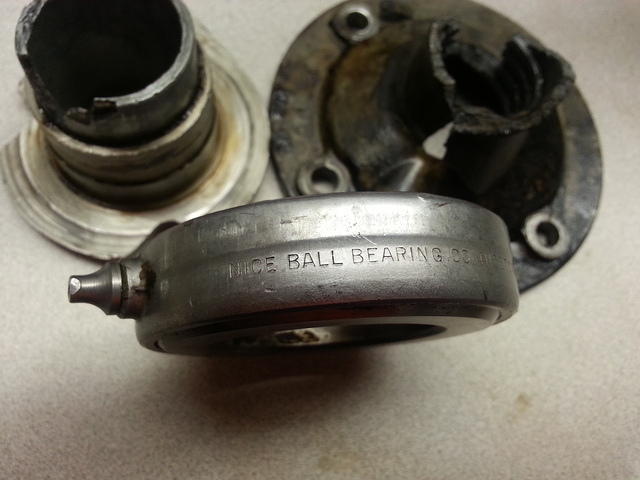

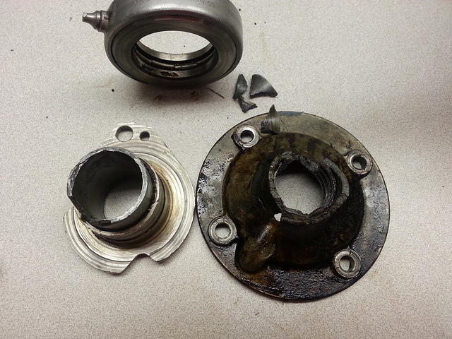

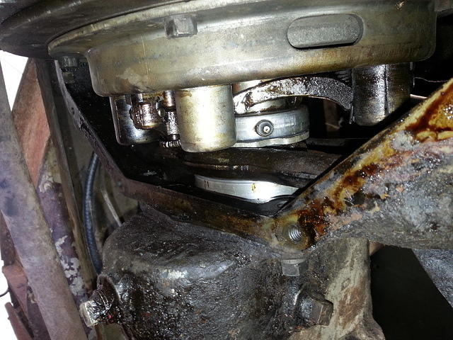

After the last gap settings the engine ran very smooth except for the knocking.  To eliminate all problems with the gap setting I tightened the gaps again today which didn't affect the clunking.   At this point I am convinced the sound is coming from the rear of the crankcase.   Maybe something broke when the engine chewed up the pressure plate.  I am dropping the oil pan to get a look see.
I used a long screwdriver to listen to the block vibrations.  Starter motor bell housing OK, Distributor base OK, even the area around the tappets was soft.  No bangs coming from the oil pump.  Sound definitely coming from the rear and below the valves.
