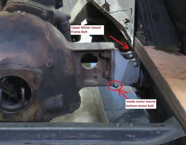

Chet - would you have a pic of this?  I want to make sure I'm visualizing this the correct way when it comes to this passenger side ground strap:
"...which attached to the passenger side rear motor mount frame bolt and also attached to one of the two bell housing bolts that attach the bell housing to the motor mount."

Hi Ted,
This is the best I could come up with.  The strap connects to the bottom bell housing (motor) bolt inside the motor mount and the other side connects to the top motor mount frame bolt.  The most important thing is that it ensures good conductivity from the frame to the bell housing and motor.  If you install one make sure no paint or crud insulates the connection.
In the picture below you can see a hint of the strap sticking out the bottom of the motor mount.
Ted,  another pic of passenger side.
