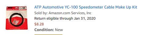

Hi Tom,
I purchased a Universal 0.130 Cable from Amazon for 8.95.  Free shipping for Prime member.
The cable is squared on one end and the 0.130 OD is correct to fit into the speedometer.  It does not come with the transmission key.   The one packaged with the cable is also squared, so you need the proper key.
I was able to reuse my transmission key .   Cut to proper length, greased the cable and it is now working smooth and quiet.
:) Chet...
