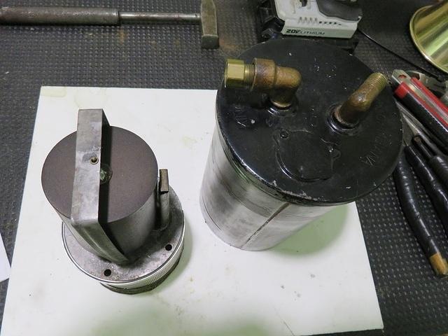

While waiting for my speedometer cable I started work on the Kingston Vacuum pump.  Thanks to Russ T. Fender I had some extra parts that I am sure I will be able to get this working, I hope.  I cleaned everything in the ultrasonic cleaner.  Between the two Vacuum pumps I have I was able to get one top unite repaired.  See Below.
The NITROPHYL® Float Material I purchased from Restoration Supply Company.  It is 2" X 3" long.  I cut it down to 2.5" long.  The normal width of the float is 1.5" but the 2" float works OK.  I shortened the 3 inch length because of the added width of the new material.  Hopefully it will maintain the proper fuel dump to the lower fuel chamber.

With the top unit apparently ready to  go I worked on the leaky canister.   I soldered all the known areas in need of repair and then, I plugged the bottom hole and filled the canister with water.  I still had a spot that was leaking so I emptied the canister, dried it out and soldered the remaining leaks.  To stress test the canister I filled it with parts cleaner solvent and let it sit overnight in a vice with a paper towel below it.  No leaks the next day so looking good.
I cleaned it once again and painted it black.  After a day in the warm house to dry, I completed the assembly of the pump.  I ordered a fuel shutoff valve and other stuff from Restoration Supply.  When I get the parts I will install the pump in the car.  I feel pretty confident that it might work.  It's such a simple device I can't see it not working.  If all this fails I still have my electric pump to go back to.

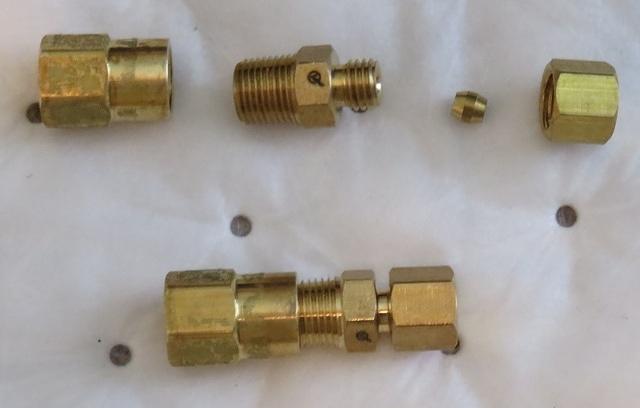

My Plan:
The 3/16 inverted flair to 1/8 pt converter screws onto the old female tubing fittings.  I should then be able to go from 1/8 pt to 1/8 OD copper tubing compression fitting.
This will work just fine:
Thanks rwollman for the quick reply.   Chet...
rwollman
Chet - re-used fittings that were there - fittings on copper line were of a ball design soldered on. Best I can explain is that they looked something like 1/2 compression ferrule.  We just unsoldered and re soldered them on new line.  I might be able to make them on lathe.  Is this what you have?
