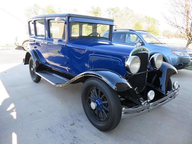

As of yesterday I finished the work to the front end.  Restoration officially finished.
  • King Pins replaced
  • Front wheel Bearings and Races
    Inner Bearing:           Napa - BR14130
    Inner Bearing Race:   Napa - BR14274
    Outer Bearing:           Napa - BR09074
    Outer Bearing Race:   Napa - BR09194
  • Dust seal: CR 18242 from Northeast Parts  (northeastparts.com)
  • New front brake shoes
  • New drum on driver's side. (NOS)
Car drove nice. No wheel bangs or scrapes.  The front end was tight and responsive.  The Vacuum Fuel pump is still working without issue after 4 hours of total run time.   Drove 30 continues miles at an average speed of 30 mph.   Idle oil pressure 20-25psi  max run 35-40 psi.  Motor meter engine temperature cool.  62 degree day.  Engine break-in runtime 16.3 Hours.  Total driven miles 91.1 (car speedo)

I like your outside rear view mirrors. Where did you get them?
John, I bought them one of the years I visited Hershey.  I have been collecting parts for years.  Sorry I can't supply a contact.
FYI the front wheel seal worked perfectly.  Also the NAPA bearings and races fit perfect.  Found those part numbers on Tods web site.
Ok. I have seen them in Ford Model A Catalogs. I'll have to try one if those, with an extended hinge pin.
