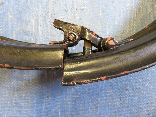

I removed one of the old Allstate tires from its split rim.  Quite a job.  The tire was petrified and I had to cut it with a jig saw in order to pry it off the split rim.  So much for complaining.  My problem is that the split rim opened fine but doesn't want to reclose.

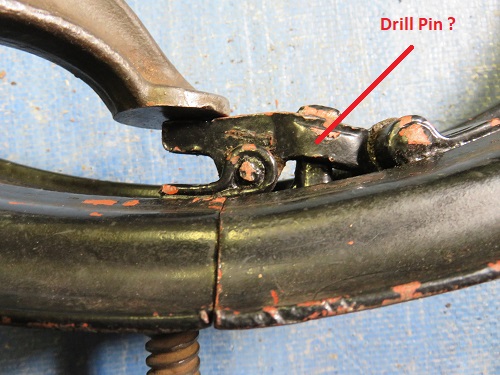

I was thinking of drilling a hole to install a pin ??  Any tricks I am missing ?
I didn't want to hammer the post in fear that it might break the mounting rivet.
Any Suggestions.
All looks good . Once in tire will not snap open . On my spare I lock with tie wire as you show . Was afraid some one at car show would mess with . I had one violently open when bouncing to seat new tire . It blew tube when it can out .
Did you use a rim spreader?  If you use a rim spreader it should seat the two ends and the lock will close with little or no force required.  Once the rim is on the wheel it can't open but it can if you horse it around off the wheel.  I'd drill and use a small split pin if you are concerned.  It doesn't need much to keep it closed.
Quote from: Russ T. Fender on October 31, 2021, 04:24:35 PM
The lock closes no problem it just doesn't stay closed. It pops right open.
I agree.  I will drill it for a small pin.    :). Many thanks

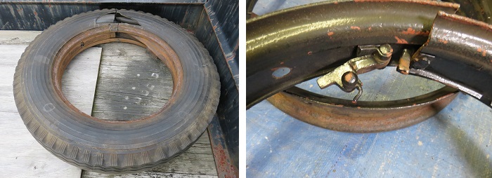

Well I spent another day screwing with these 19" 30u wood wheels.  I removed another tire which was a battle.  Those All State ( 6.00-19 6 Ply ) tires after some 50+ years are hard as a rock.  I removed the air valve to release the air and the tires still would not flex.  It was like they were filled with cement.  OK I'm exaggerating a bit.., but still very close to reality.  I had to cut the tire to get a little bit of play to separate the split rim even with using the Atlas tire tool.  Unfortunately the Kelsey latch is broken on this rim.  I guess I could weld it back in place.

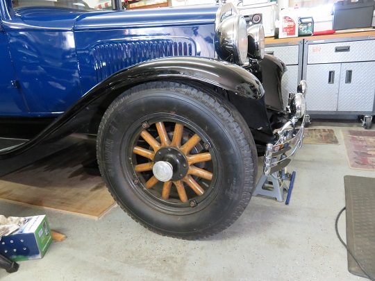

Well I gave it one more try.  I installed the new drum on the old wheel and everything seemed OK.  I took it out for a drive today and clocked 25 miles.  The brake problem was fixed and I thought that was it .  Pulling the car into the garage I could hear the passenger side wheel clicking.  I jacked the car up and the wheel had to much side to side play.  At first I thought I had a loose wheeling bearing nut but it was the wood spokes.  This has been an ongoing problem with this wheel.
Anyway I will take the wheel to be respoked but I still might need to move my car so I installed the 19" wheel with the 6.00-19 6 Ply tire.  This wheel with that one good tire is two inches larger in diameter then my stock 20" wheels with the 4.75/500 20" tires.  see below:
Oh well,  Chet...
PS.., The wife loves the wood wheel look.
