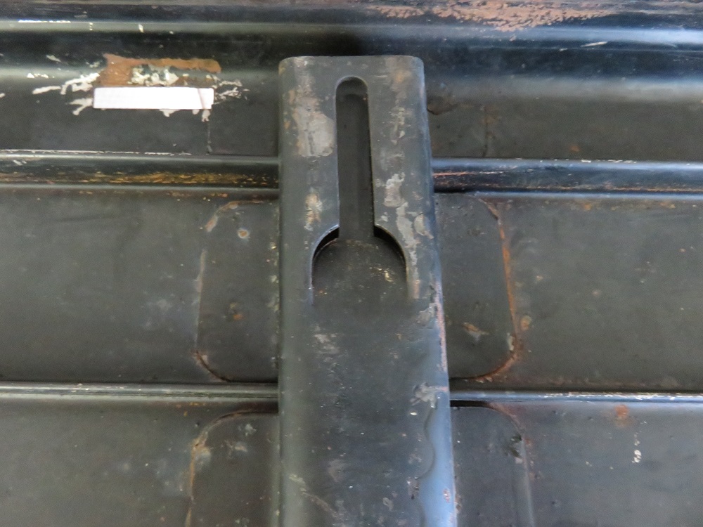

Ted your leaf springs are looking good, you're all set for 2021.
Thanks!  The springs did come out nice and a quieter ride with everything done.
